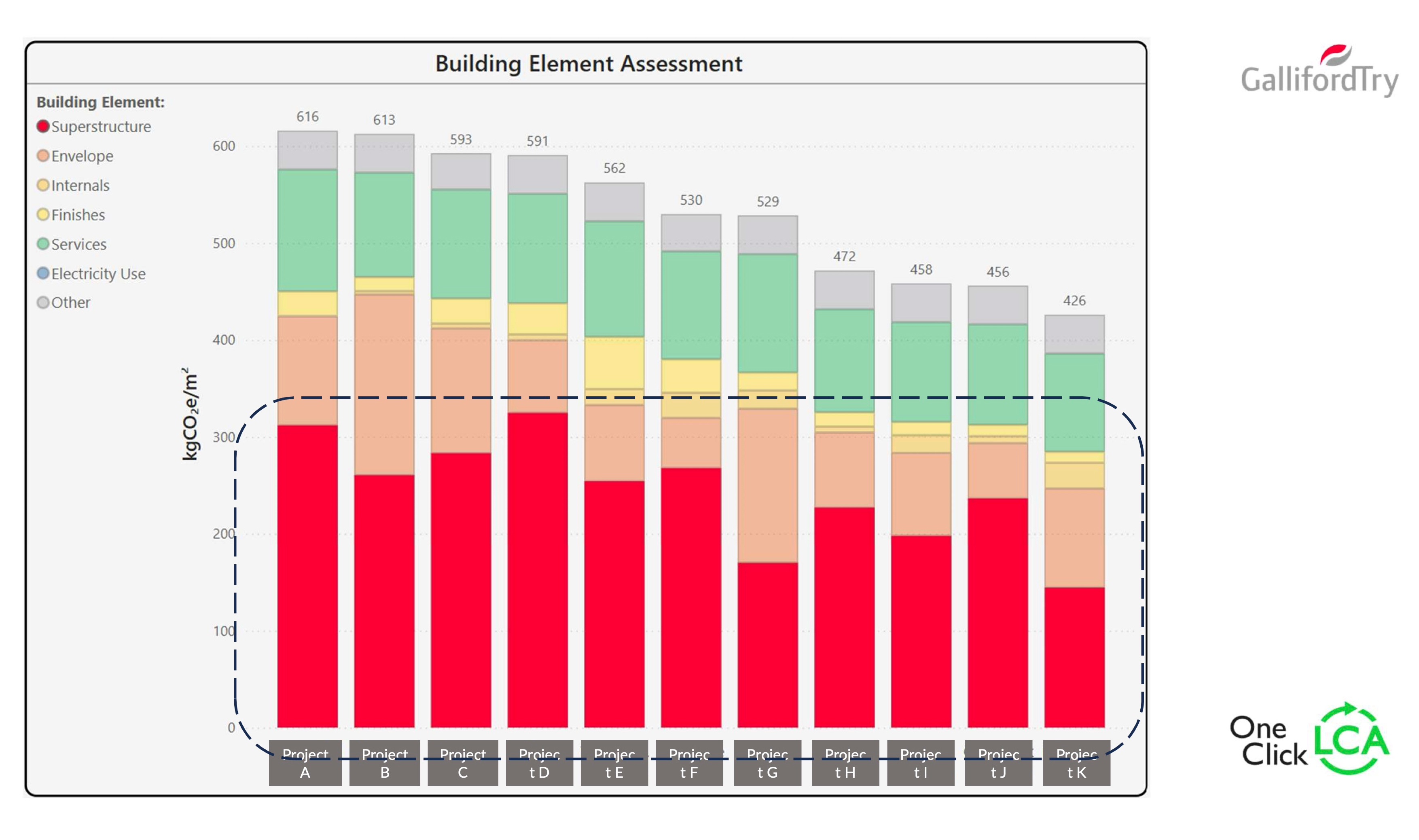

Portfolio assessment: Where learning actually happens
Project-level optimisation alone does not build organisational capability. Scope 3 maturity emerges when performance is assessed across portfolios, using a consistent methodology.
When multiple projects are benchmarked against the same embodied carbon pathways, patterns emerge:
- Some schemes sit well above 800 kgCO₂e/m²
- Others approach 400 kgCO₂e/m² for comparable scopes
This spread is not a failure of consistency; it is evidence of learning in progress. It shows where design strategies, structural efficiency, specification choices, and procurement approaches materially affect outcomes. This is what allows organisations to standardise better decisions, rather than relying on exceptional teams or one-off projects.
“Single projects can look exceptional or disappointing in isolation. Portfolio assessment is where you see which decisions genuinely work — and which ones you can scale,” said Allan Smith, Low-Carbon Manager at Galliford Try
Portfolio benchmarking enables organisations to move beyond anecdotal success. Instead of asking “Which project performed best?”, mature teams ask “Which decisions consistently reduce carbon, and can we repeat them?”
