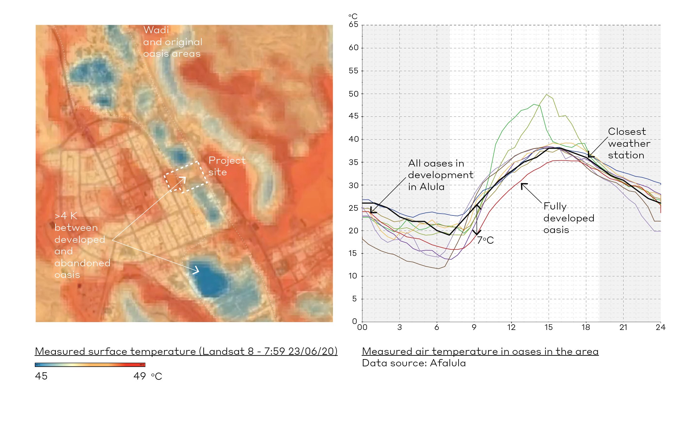

Today, the oasis on site shows land surface temperatures over 4°C warmer than an oasis nearby, showing the site's undeveloped microclimatic potential. Additional air temperature data, recorded in local oases by French agency Afalula, further supported this: a fully developed oasis shows air temperatures up to 7°C fresher than the weather station in the mornings. Once identified, it became evident that the project had to find a way to capitalize on this untapped climatic opportunity.
Land surface temperature on project site and extract of measured temperatures in a range of local oasis by Afalula

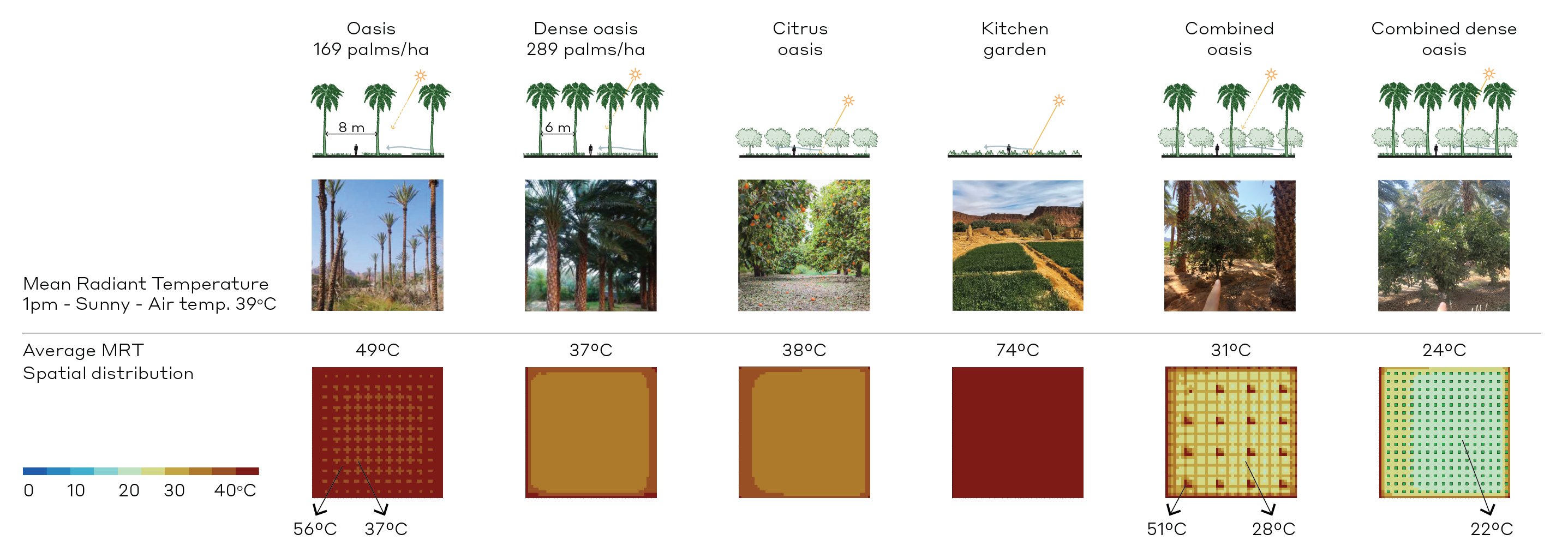

Learning from the local oases in the area, six configurations were developed responding to the programme needs. They ranged from a sun-exposed kitchen garden to a dense, multi-layer oasis combining palms, citrus trees, and ground vegetation. ENVI-met modelling was backed by long-term temperature and humidity monitoring data from a range of real oases in the region, shared by Afalula and previously shown, which confirmed that field evidence and modelling told the same story. This combined technical approach showed that:
Restoring the oasis must be done carefully, as certain parameters such as plant density and species can reduce air temperature by up to 7°C in the morning when compared to a local weather station. An uninformed restoration could keep air temperatures similar to those around the weather station, or even above by 10°C or more.
Food growing areas matter for visitor comfort. Isolated garden types show mean radiant temperature (MRT) differences exceeding 50oC: a sun-exposed kitchen garden reaches 76°C; a low-density palm oasis 49°C; a high-density palm oasis 37°C; and a citrus oasis 38°C. The traditional combined oasis performs best, with the lowest MRT at 31°C (or 24°C with higher palm density).
Six oasis configurations that respond to the programme agricultural requirements

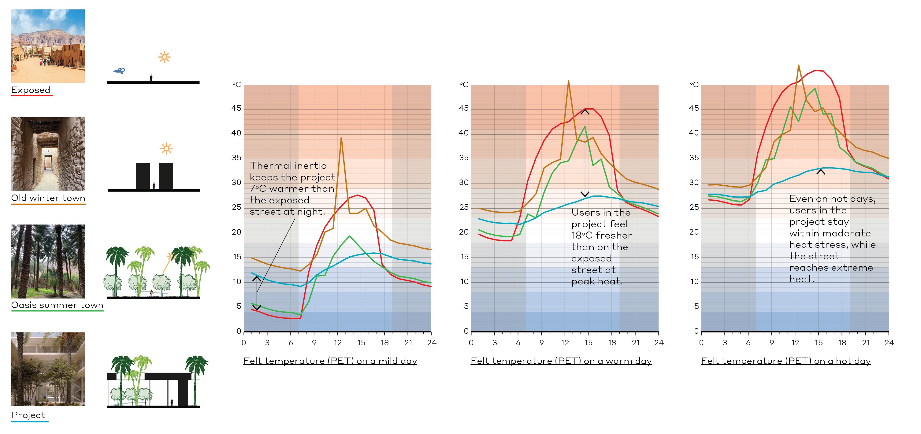

Traditionally, the local population relied on a winter town with covered narrow streets and thermal mass that would retain winter solar heat into the cold nights, and a summer town located within the fresh oasis. These evolved in response to the specifics of the local climate, at a time when little energy was available. Drawing from these learnings, a design solution was developed in line with the local climate and the dual conditions of the site: a compact, elevated and thermally massive construction on the west city side, and a sparse collection of small buildings within the oasis.
View of the city plot from the west (left) and view of buildings within the oasis (right)
ENVI-met modelling was used to assess the proposed project solution on the city side, alongside the traditional local typologies. Felt temperature (PET) was simulated and assessed over three typical days: a mild winter one, a warm one and a hot one. On the coldest night, within the mild-day scenario, the project typology is some 7 oC warmer in PET than the open street and summer town, shifting from extreme to moderate cold stress. On warm days the pattern reverses: users in the project are approximately 18oC fresher than the exposed condition, which reaches extreme heat. On hot days, the project typology remains the best performing, thanks to its ample shade, small courtyard oasis, and heavyweight enclosures, staying around 12 to 20oC fresher than the rest.
Felt temperature (PET) on a mild, warm and hot day for the project configuration and traditional references

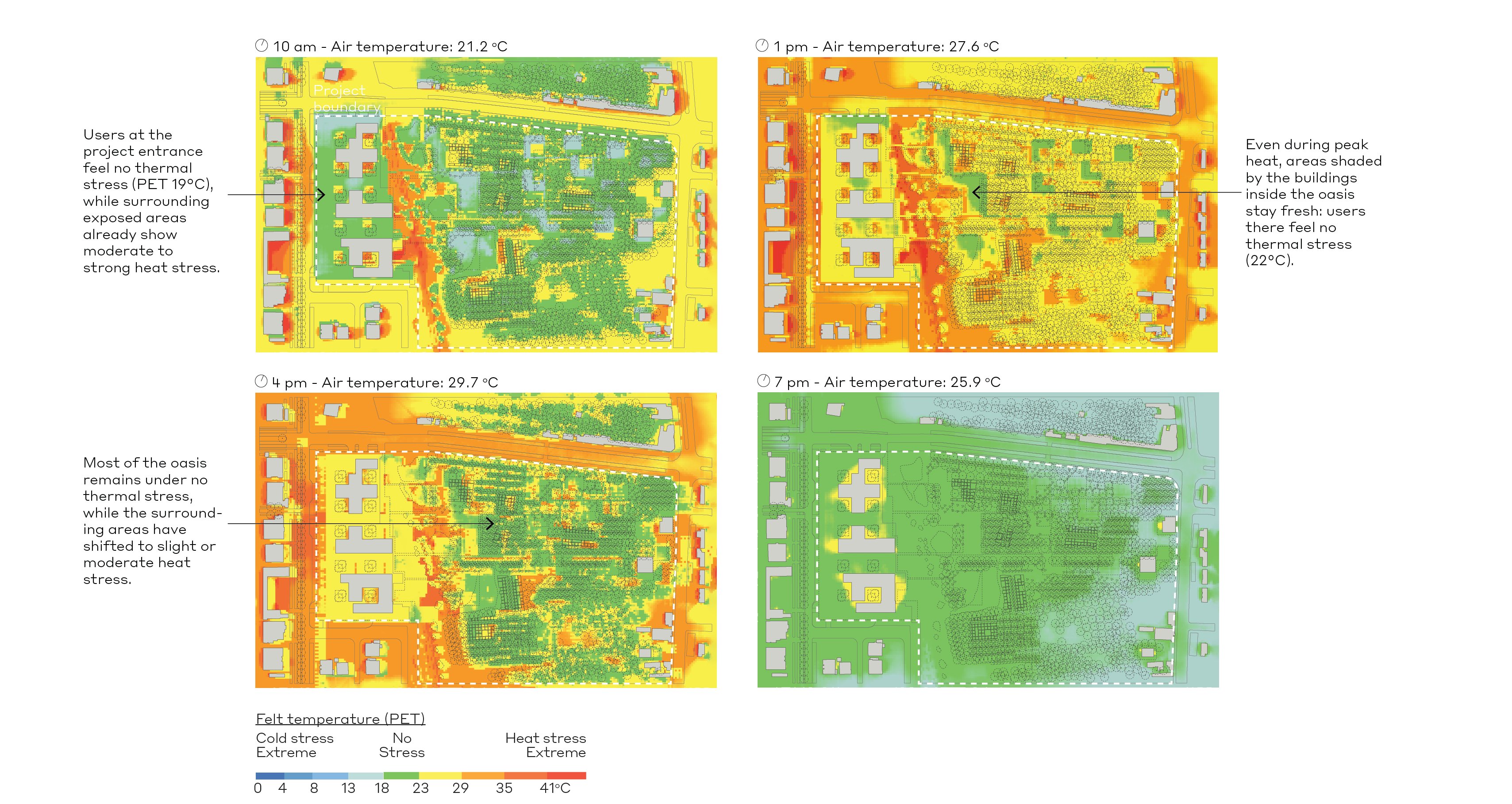

Felt temperature (PET) maps were analysed at four representative times of the day on three typical days, while nine sample points were assessed over each entire day. Only PET map results for a warm day are shown below for brevity, and highlight the impact of the microclimate strategies on the conditions visitors will experience on site:
The project site functions as a cool island, as felt temperature within its boundary is always at least one stress category closer to comfort than the city and street areas surrounding it.
Users reaching the project from the city, or lingering on the entrance areas, experience no to moderate heat stress during the entire day, while the street they just came from can reach high heat stress most of the day.
Visitors to the oasis park always have an area of no heat stress, even during the time with strongest sun (1pm). Areas below the dense shadow of the elevated buildings are the only areas in the vicinity that offer a respite from heat stress.

Feels-like temperature (PET) during a warm day in all project areas

The project is a cool island during warm weather, staying up to 18oC cooler in felt temperature than its surroundings, and up to three heat stress categories. This is not a single peak-hour effect: it holds across every hour of the day, shifting occupants down by at least a full heat-stress category.
