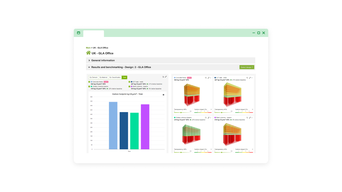

Models following these practices will be importable seamlessly into One Click LCA. It is also possible to work with imperfect models, and the process for this is explained in our separate in-depth guidance. If you are using One Click LCA Business or Expert license, you can use the Model Checker tool to identify potential issues automatically.
Want to see how our Input Checker and Model Checker tools help you to perfect your BIM model and verify your LCA results?
