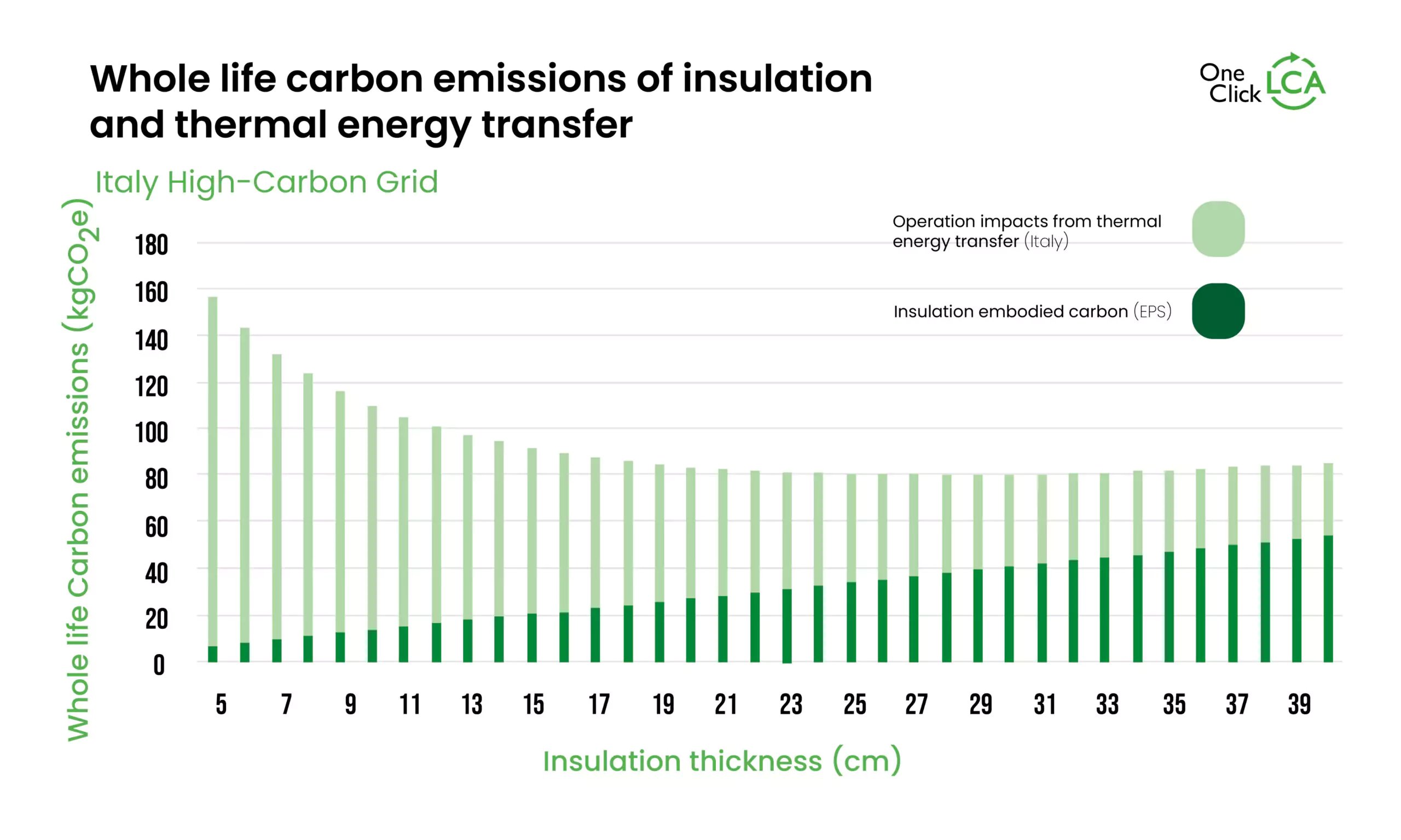

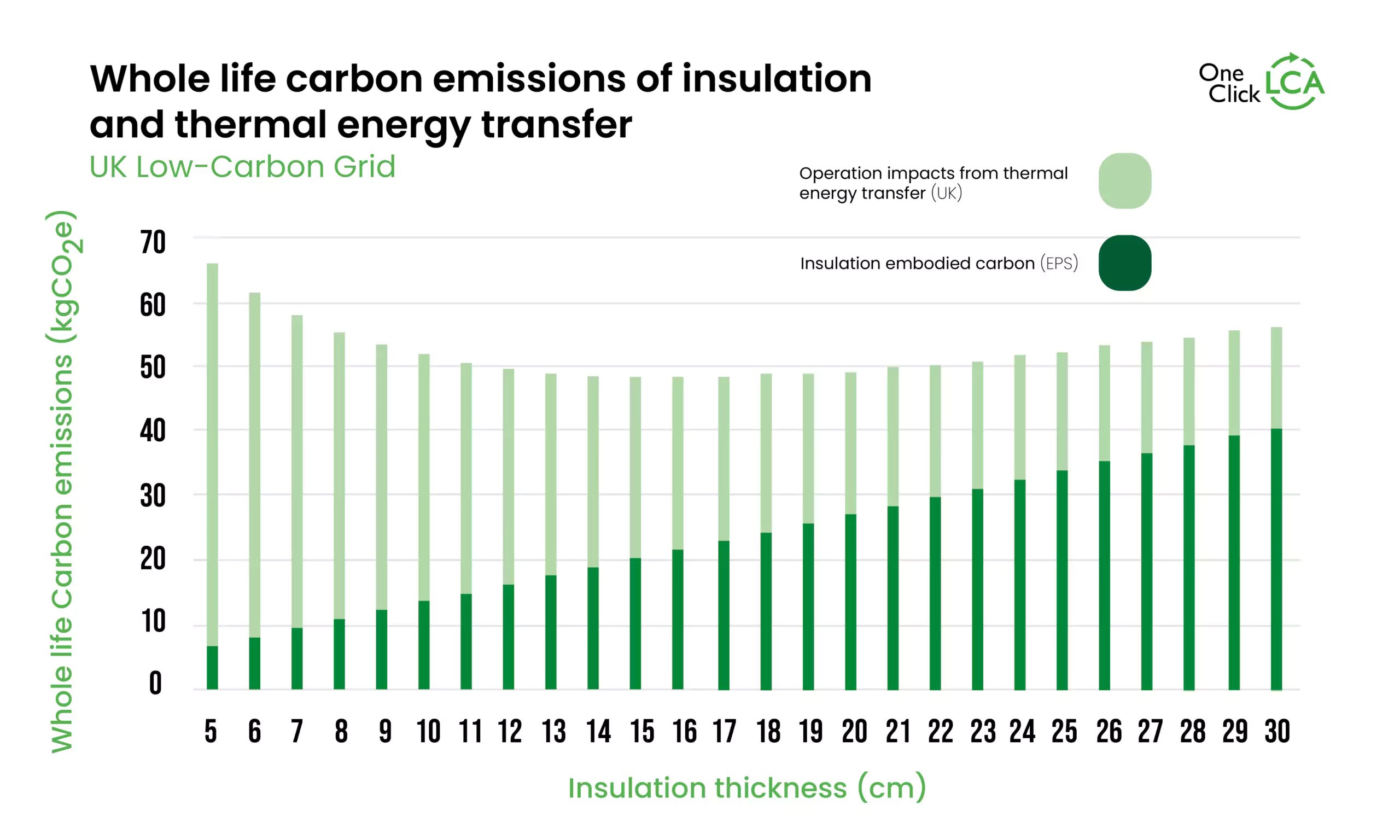

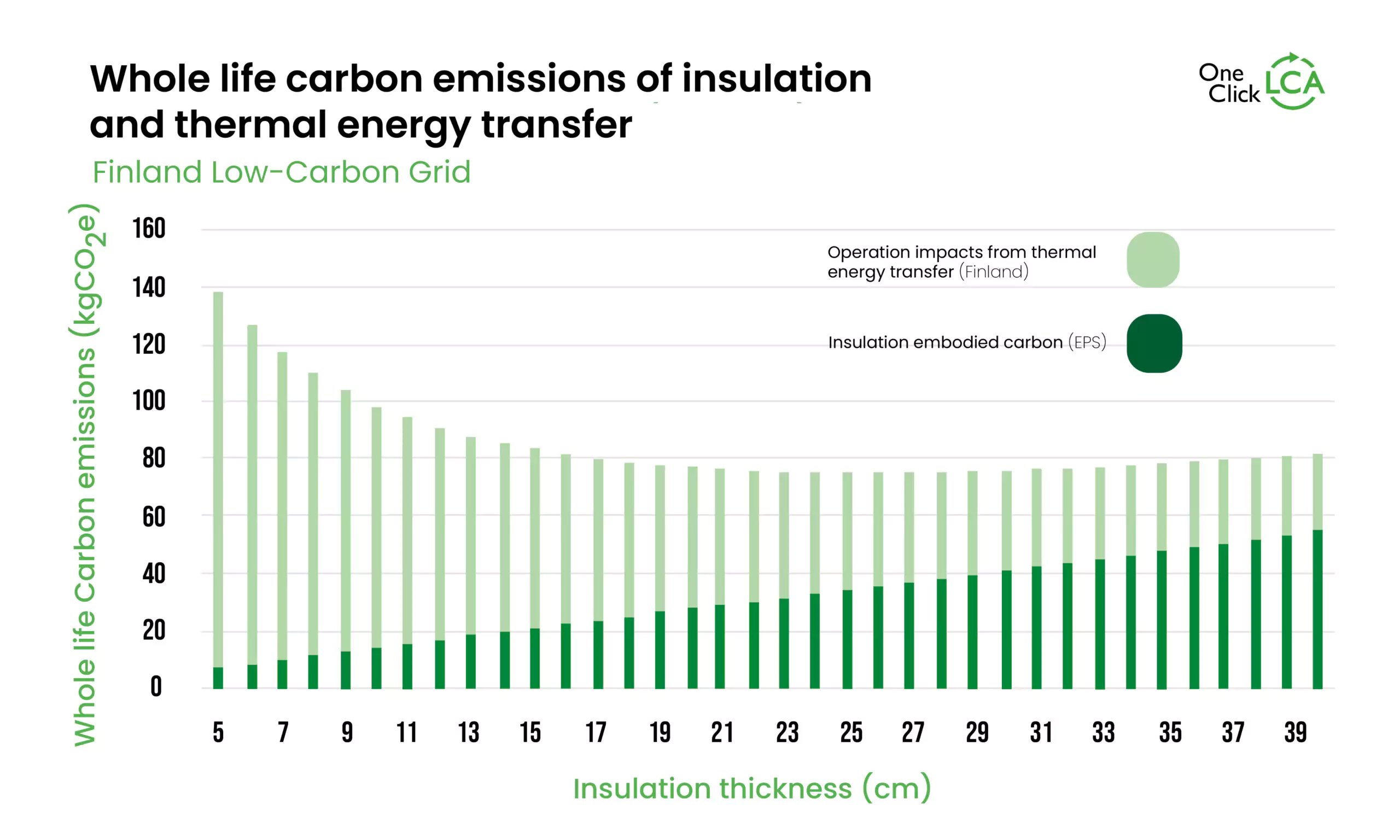

The Trade-off: Operational Carbon Savings vs. Embodied of Additional Insulation
The following graph illustrates the balance between operational carbon savings and embodied carbon in different scenarios across Helsinki, London, and Rome. The study evaluated heat transfer in one m2 of the insulated brick wall with heating provided via air-source heat pumps. The insulation used was assumed to be EPS insulation with a thermal conductivity of 0.034 W/mK. The baseline design featured 5cm of insulation, assuming round-the-clock conditioning throughout the year. The insulation’s service life is aligned with the building’s lifespan of 50 years.
article_image_ecodesign-insulation_insulation-landscape
Scenario Average annual temperature difference Electricity grid carbon intensity (kgCO2e/kWh)
Helsinki, Finland 15°C 0.16
London, UK 7.75ºC 0.14
Rome, Italy 5.6ºC 0.49
The following graphs determine the optimum insulation level for each country (Finland, UK, and Italy) The electricity grid carbon intensity considered in this study represents the current carbon emissions per kWh in each country. As the electricity grid is set to decarbonize within the next few decades in all three countries, the insulation thickness should be specified well below the optimum point shown in these graphs. Alternatively, if data is available, an average carbon intensity factor may be taken into account in similar studies that represent average annual emissions from today until 2050.
